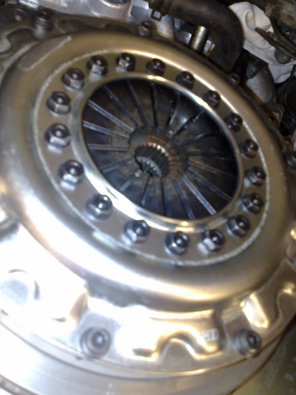

    Hey guys i could do wit a little help ere,
    I rebuilt my redtop sr20det and i decided to go wit a OS Giken TS2BD
    Twin plate clutch,
    fitted it al grand an al went to plan, went to go try it, but it wudnt go into gear at all
    pedal felt funny like as if it was only pushing d pressure plate at d very last of it, but not far enuf, bled d slave cyclinder an al but it was fine
    had to get d car rolling so i threw back in my old exedy flywheel an clutch and it was perfect like b4. here is a pic of the clutch an d order i put it in
    an i added a pic of it fitted in d car, its like d pressure plate fins are very close to d disc, or luks like der even touching d disc
    has a little copper grease dat escaped on d disc from d gearbox shaft and if u luk closely d marks from d fins r on it?
    Any help on this would be great guys! ne1 any suggestions or experience wit dis?

    i fitted one of those to a 4ag before, there a VERY harsh clutch, no need untill running mega power tbh but..... you could have put them in the right order but have you putt 1 or 2 of the disks in the wrong way round????

    harsh clutch hows dat dude? i just want to know wat im getin myself into , (broken left leg for example?) its not a road car. emm yep put them in ok, dey can only go in d one way
    393
    338
    as in the diaphragm springs in the clutch are very stiff so that makes for a very stiff pedal and its biting point is like a button lol, but i dunno you might like it, its deffo not a clutch for a daily road car anyway,
    without seeing it all i could say is double check everything is in the right way around, is it deffo the right clutch for the car? is the realese bearing in right?

    was told it cud be the carrier maybe? mite av to get a shorter one ill just keep researcing i suppose , like a button???....... sweeeeeettt!!!! dats if i get it fitted ok dat is lol
    Pro Driver
    496
    1,145
    did you use the factory release bearing if so these clutchs run another
    type release bearing...os giken in the uk have them in stock

    @carpo... really? wuda thought it wuda came with the kit? or dey hard / expensive to get man? i just use the factory release bearing, goin to put in a rb25 box now so do u know if these are the same? thx man
    Pro Driver
    496
    1,145
    thats ur problem i would think ring up os giken in the uk today
    they have them for around 50 pound i think..
    all the os-giken clutchs run a diferent release bearing to the standerd one
    601
    kerry
    316
    your slave cylinder might not be strong enough if you want a softer peddle you can get a nismo slave cylinder makes the clutch lighter on the leg
