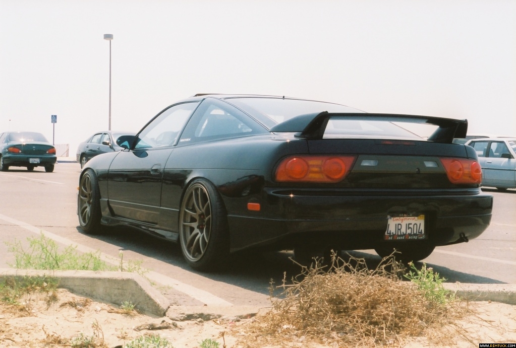

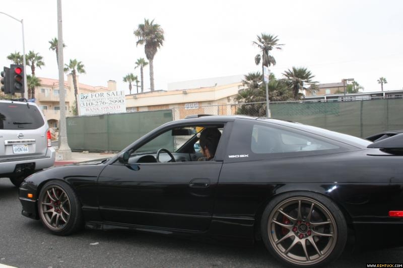

    ir your wheel offset is +5 and you spacer is 4mm , it would give you an offset of +1.
    tese 2 cars have the exact same wheel size and offset as you would be running and they only have rolled arches and a bit of stretch.
    if the offset info you have given is correct, you wheels would be lost under 50mm arches
