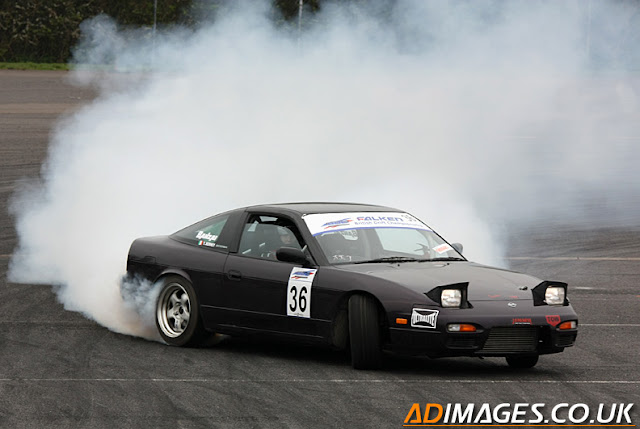

    Hey lads, ive always said to myself id would do a build thread but kept putting it off, ive had this car since mid 08, an ive a few pics to upload to get this up to date..... ill prob do this over time during the winter evenings comments an advice/tips always welcomed
    I bought it pretty bog standard an imported it from japan
    Pretty much just fitted a roll cage, welded the diff, intercooler,bucket seat an managed to get a round or two in before the year was out
    That pretty much was 08
    for 09 done a few bolt on mods, fuel pump and adjustable reg and actuator, stainless steel manifold and sprayed the car midnight purple and bought some rota grid alloys
    Went across the pond to wales an got my semi pro bdc license
    had a great year
    finished 9th in the championship which i was pretty happy with considering i missed 2 rounds
    sooooo thats the boring stuff outta the way...........
