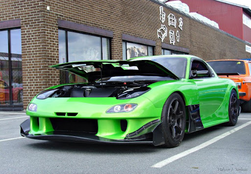

Heres the pics as she stands now
...I have a couple of ideas in mind for the bodywork, ive taken a shine to one of the veilside kits! I will post pics up of a few......
