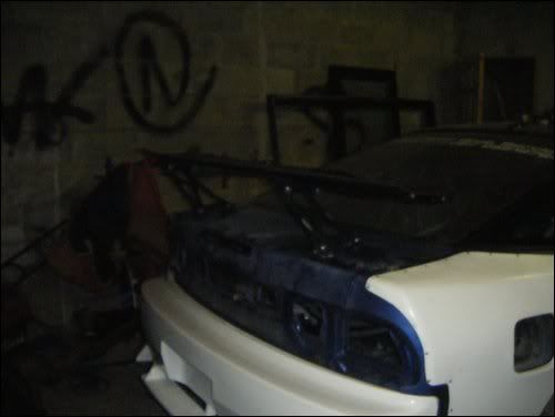

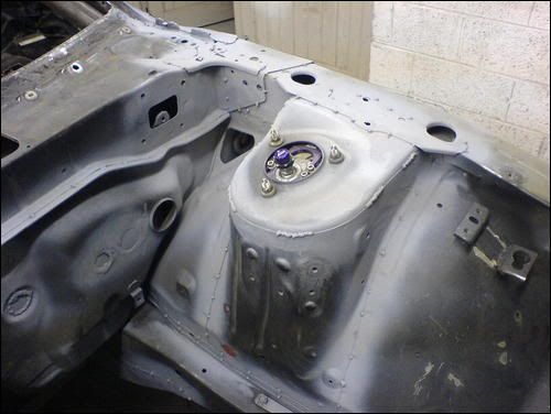

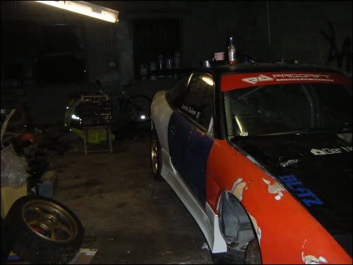

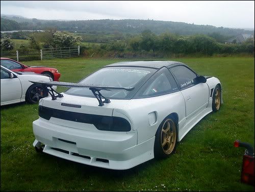

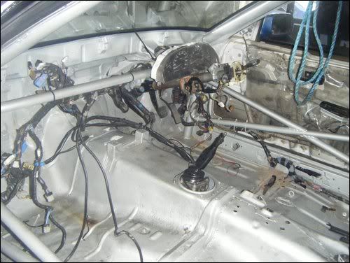

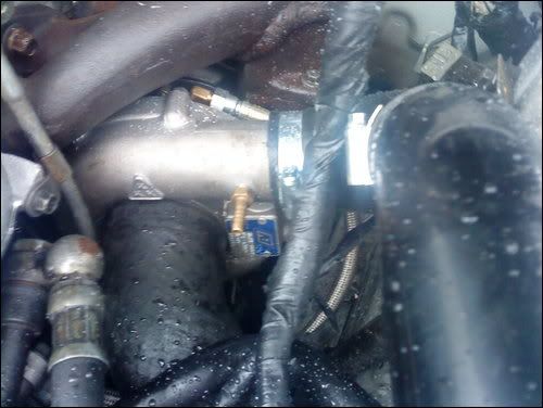

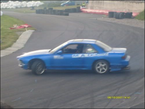

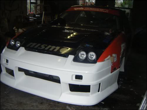

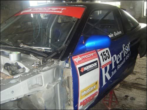

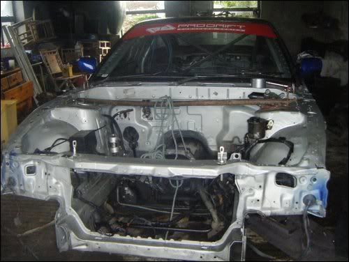

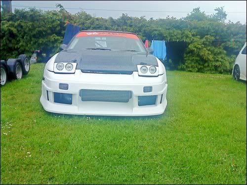

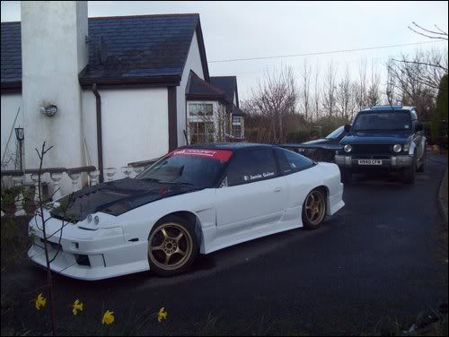

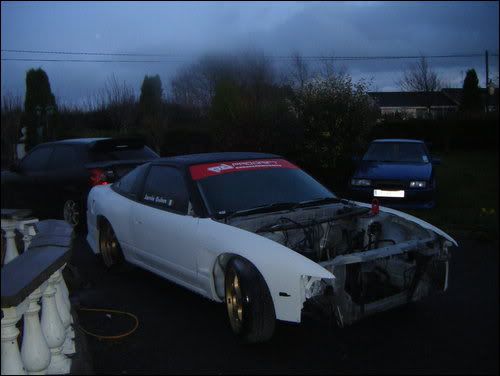

rite ladsmay as well pt up a thread on my 180sx project its almost there now so ill throw up a bit about the build
spec

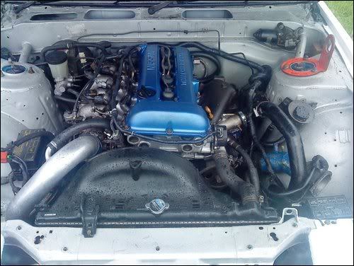

custom jrp steel liners
87mm custom jrp spec'ed pistons(CP PISTONS)
Crower rods
rnn14 GTI-R oil pump
nismo 850 cc injectors
bosch 044 motorsport fuel pump
converted to e85
new nissan waterpump
head ported and polished
bc 256 cams
acl race bearings
arp head and rod bolts

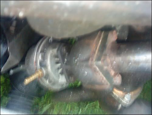

blitz kkk450r turbo kit with ext wastegate
3"downpipe with decat
greddy cat back exaust
exedy 6 paddle clutch with double diaphram pressure plate
welded 4 1 diff
stock sr box for the moment
ajustable arms in rear unsure of make
kazama torsion rod
tein tie rods
5 stud conversion with grooved disks all round
cusco zone i coilovers
12 point weld in cage
omp bucket seat
omp steering wheel
hydro wand
3"harness
blitz air filter
fmic
3 core rad
hks twin electric fans
blitz boost controller
link ecu
full vanquish kit

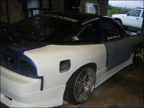

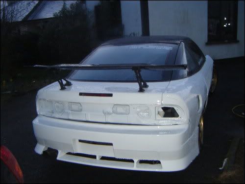

30mm vented wings
50 mm quarter panels

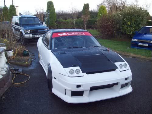

frp vented bonnet
frog eye headlights
smoked euro style rear lights
frp roofskin
17" rays gram light gold wheels
resprayed toyota 040 white and toyota black
all engine work carried ot by jr performance
my old onevia (doner car)
