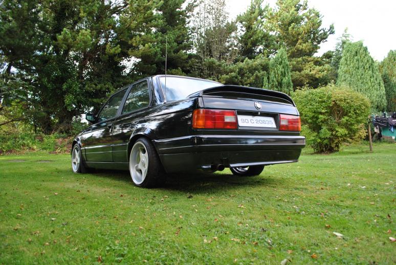

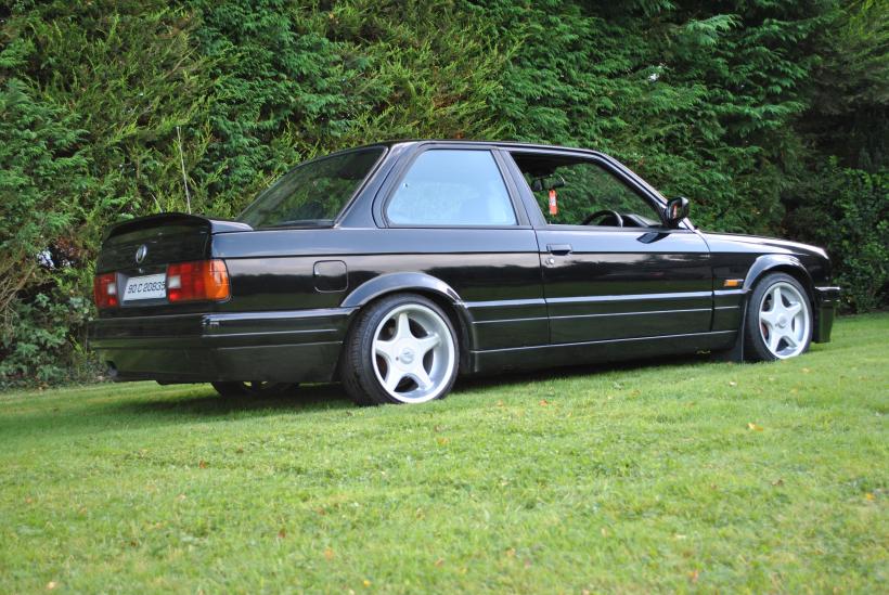

SPEC:
ACL RACE BEARINGS MAINS & BIG ENDS
WOSSNER PISTONS 0.5MM OVERSIZE & WOSSNER CON RODS
1.2MM COSWORTH HEAD GASKET
ARP HEAD BOLTS
HKS CAMS 256/264
BC VALVES, SPRINGS & RETAINERS
TDP CUSTOM TURBO
GREDDY MANIFOLD TOP MOUNT
GREDDY WASTEGATE
GREDDY SUMP
GREDDY OIL COOLER
GREDDY CATCH CAN
GREDDY FRONT BRACE
KU INTAKE MANIFOLD AND & LARGE THROTTLE
SARD FUEL RAIL & 750CC INJECTORS
SARD FUEL PRESSURE REG
UPGADE FUEL PUMP
KOYO ALLUMINUM RAD & ELECTRIC FANS
3’’ EXHAUST TURBO BACK MEGAN RACING
ALL UPGRADED SUSPENSION ARMS, SOLID SUB FRAME BUSHINGS
TEIN STEERING RODS & ENDS
IKEYA FORMULA FRONT WISH BONES
BC HR COILOVERS
TOMEI 2WAY
4.3 FINAL DRIVE
EXCEDY 3 PUK SINGLE PLATE
FRONT END ALL SEEM WELDED
FULL CAGE BY MURRAY MOTORSPORT
2X SPARCO CORSA SEATS & 6 POINT SABELT HARNESS
HYDRO HANDBRAKE
ABS AND ALL ORIGINAL BRAKE LINES REMOVED AND RE PIPED FROM MASTER CYLINDER
WILLWOOD 12’’ LIGHTWEIGHT 4 POTS FRONT BRAKES
R34 GTT REAR BRAKES WITH MINTEX RACING PADS
MOTEC ECU
APEXI AVCR
444 HP @ 5600.RPM
ENGINE BUILT & MAPPED BY TDP.IE ALSO SUSPENSION SET UP
URAS KIT
C-WEST SPOILER
ROTA GTR DRIFTS 17x9.5 FRONT
ROTA GTR DRIFTS 18x9.5 REAR
Let me know what you think lads finaly all the stupid things sorted took a long time to get everything right its me first drift car and not much experience but its finished now so just have to learn to drive it now:eek: haha..
